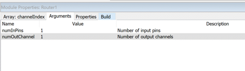

The router_module.m is an intelligent copier and combines several channels from different wires into a new multichannel wire. The module can have multiple input pins but only a single output pin. At instantiation time, you specify the number of input pins and number of output channels.
M = router_module(NAME, NUMINPIN, NUMOUTCHANNEL)

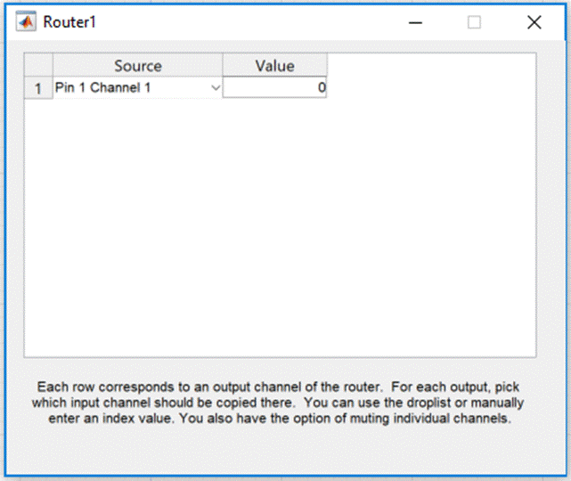

The module has an internal array channelIndex[] of integer values. The array has length NUMOUTCHANNEL values and value N specifies the mapping from input pin and channel to output channel N. Keep in mind that all indexes (both for pins and channels) are zero based.
The channelIndex integer is a packed 32-bit value
channelIndex = (pinIndex << 16) + (channelIndex)
or alternatively
channelIndex = 65536 * pinIndex + channelIndex.
If channelIndex is incorrectly set and the encoded pinIndex or channelIndex are out of range then the module will mute the corresponding channel. The Router module performs a straight copy of data and supports all 32-bit data types. The Router module is ideal for fixed routing configurations. If you want to make changes to the routing table at run-time, you should use the smoothly varying RouterSmoothed and RouterSmoothedFract32 modules.

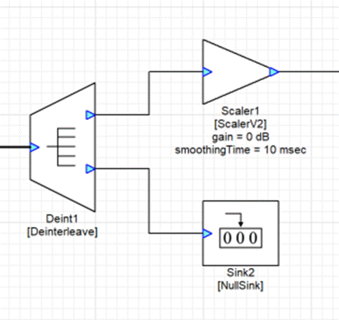

Example #1 — Selecting a single channel
This is wasteful because it requires 3 modules to do what a single router module can do. Create a Router with 1 input pin and 1 output channel.
The desired left output channel is on pin 0 and channel 0 so set .channelIndex to 65536 * 0 + 0 = 0.
The system only requires a single Router module now:
If instead you want to pass the right channel, set channelIndex to 65536*0 + 1 = 1. The string shown on the canvas will update showing you the specified channel ordering:
